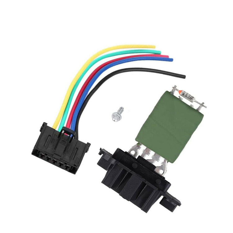

  23. I have had issues with the motors before as they are cheaply (and badly) manufactured in China and kept packing up Have replaced resistor packs as well and the is a wiring modification for a new plug so not sure if this may be a cause?
  24. Thanks for providing us with feedback and helpful for any members who are in the same situation. Cannot believe the dealers didn't pick up on this, but always good to know a decent independent garage who can solve issues like this
  25. may be cheap resistor pack and maybe try one from a different supplier? If it was a high resistance in the wiring then it would pop the fuse or burn the wiring
