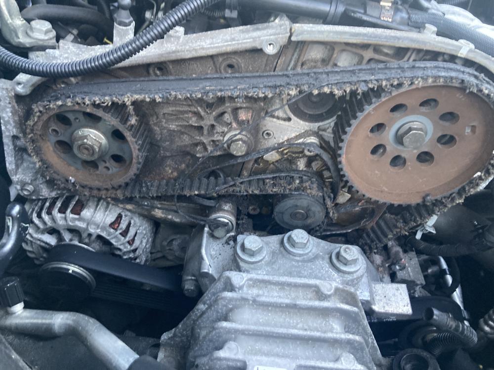

After nine years of faithful ownership my Mondeo got wrote off due to being rear ended, looking for a cheap replacement but still with gadgets I plumped a 2012 2.0 CDTI Insignia Elite A20DTH (private sale). All is good until about 400 miles later where there is rapid overheating and then sudden loss of power on the motorway, I luckily manage to cruise it into the services and await recovery.
Turns out the water pump had seized and took out the cambelt (gross picture for interest). Frustratingly it had only been done 30k ago. Obviously gutted and keen to find a fix for such a recent purchase I turn to the forums and to my relief they've been known only snap rockers and not valves (2nd gross picture for interest). I a took chance on a new (used) cam housing, lifters and rockers and fitted those with a new timing kit. After A LOT of cranking it fires up but the turbo immediately sounds bad on revving, imagine one of the modified cars where you can hear the howl. The engine then complains of high exhaust gas temperatures and shuts down, no other fault codes present. I'm fairly certain the turbo is now dead and a used one isn't an unreasonable price but I'm keen to understand what might have killed it?
