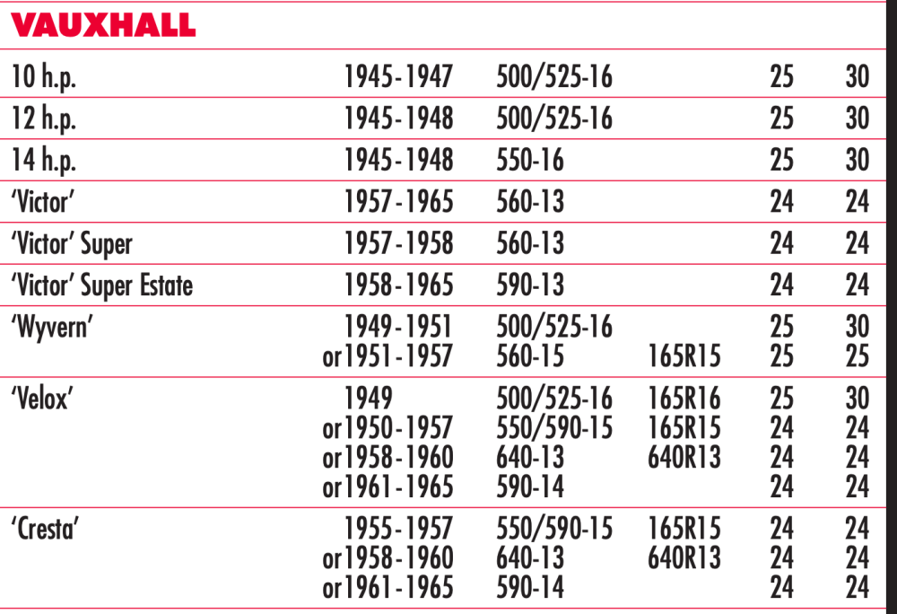

Vauxhall Owners Club Posted December 8, 2023 Posted December 8, 2023 have just found this which does say around 24psi all round (which I think is a bit low)? http://www.tyretrade.ie/wp-content/uploads/2012/08/2486-FITMENT-POSTER-CAR-NEW1.pdf Quote
Stokesby20 Posted December 8, 2023 Author Posted December 8, 2023 Many thanks for your help, I will start at 30psi and see how the car handles. and adjust the tyres accordingly. 1 Quote
