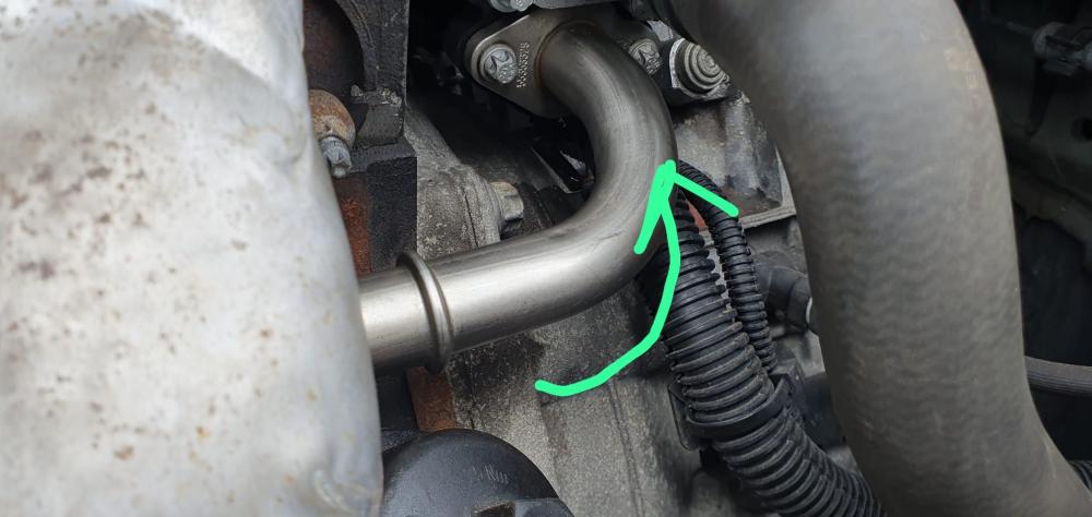

Robbie L Posted April 11, 2024 Author Posted April 11, 2024 ok so done more fumbling around and come to the conclusion that my head is completely drained, did so by partially removing the thermostat housing from the 4 long bolts to the head and not a drop, so this leads me to thinking its the water pump what has gone, so underneath is a pic of the pipe that leads from the pump to the thermostat housing, should coolant flow in the direction as arrowed? 1 Quote

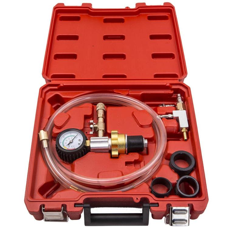

Robbie L Posted April 11, 2024 Author Posted April 11, 2024 Had the water pump off to be sure theres nothing wrong there, all is good, whilst at it ive found a bleed screw on the radiator, so at least i know my radiator is full, however i have still not been able to bleed the system fully, So the next thing is to buy a Vacuum refill kit so i can make sure there no air in the system as i fill it up.... really cant believe all the trouble im having!!! 1 Quote
Vauxhall Owners Club Posted April 15, 2024 Posted April 15, 2024 The vacuum kit looks like it should do the job nicely and at least you'll know there is no air left in the system. Check also the thermostat is not stuck closed but you should find that out if you can measure the temperatures before and after the stat with an infrared temp gun (very useful tool for many other jobs on a car - misfire, sticking brakes, etc) Let us know how you get on with it Quote
Robbie L Posted April 16, 2024 Author Posted April 16, 2024 Absolutely spot on, vacuum filled the system, got circulation flow back to the header...ran the motor for about 10 mins then the fan went off...no head damage either!! 2 Quote
