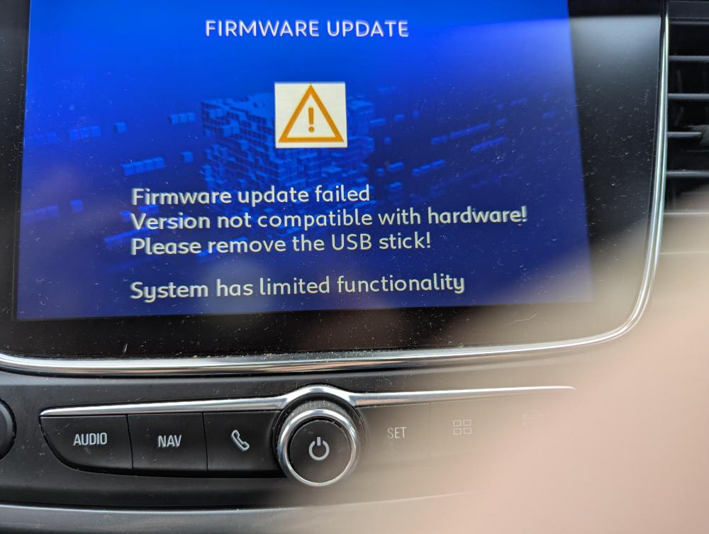

ALISON HARVEY Posted March 4 Posted March 4 Hi, yesterday I followed all the instructions from my Vauxhall app to update my soft ware and sat nav. It was the download for my VIN number. Now the screen is stuck as in the attached picture and pressing nothing has helped! Quote

ALISON HARVEY Posted March 18 Author Posted March 18 Not yet! Apparently needs a Vauxhall dealer. Can't get in till 11th April. It's absolutely naff! Quote
ALISON HARVEY Posted March 18 Author Posted March 18 Mine now says software loading on demand. System has limited functionality. Stays on for about 40 minutes after doors locked and draining the battery Quote
Jay21 Posted March 19 Posted March 19 Thank you for your response. I'm sorry to hear about the situation. I reached out to customer service via the online form, and they provided me with a direct link, but unfortunately, that didn’t work either. I even purchased a new USB stick and formatted it as instructed in their email. Additionally, I tried unplugging the battery, as suggested by some others user. It seems I may need to schedule an appointment with a dealer as well Quote

ALISON HARVEY Posted March 20 Author Posted March 20 I am just wondering . . When I put my VIN number in to Vauxhall it lists my car as a Crossland X. It is in fact an elite nav turbo which after some research this evening I've discovered has a different unit. I'm wondering if this is the issue and whether to contact Vauxhall and see if they can amend my VIN number for this version? Quote
ALISON HARVEY Posted March 21 Author Posted March 21 I've just spoken to Vauxhall. They say it's the same download even though publicity for the Crossland elite nav turbo says it's different. Not helpful at all Quote
Jay21 Posted March 26 Posted March 26 Hi Alison, I’m in Vauxhall at the moment and they can’t fix. I’ve been advised to conact customer service again. Alternatively I can replace radio and “might” work! Radio plus service would cost around £1000! Quote
ALISON HARVEY Posted March 26 Author Posted March 26 I was afraid of that? Vauxhall have sent me a different download today, say it must be FAT32 usb but the download is to being to go on a FAT32 partitioned drive. You really couldn't make it up! Utterly useless Quote

ALISON HARVEY Posted March 26 Author Posted March 26 I've just tried the link just for the software update they sent me and it still says it's incompatible Quote
Jay21 Posted March 26 Posted March 26 Last week week when I contacted customer service, they sent me a new file while mentioning FAT32. Unfortunately, this didn't work. I then purchased a new USB stick and downloaded everything again, but it still didn't work. Since I have a Mac, I wondered if that might be the problem, so I tried using my partner's Windows computer, but it still didn't work. After returning from the dealership, I called them to express my frustration, and they opened a complaint. They assured me that someone from Vauxhall would reach out to the dealer. However, the dealer claimed they couldn't resolve the issue, and I had already paid £120! Quote

ALISON HARVEY Posted April 9 Author Posted April 9 Hi Jay. Any progress on your car? I'm due at Vauxhall on Friday and been quoted almost £1400 if they have to replace the unit Quote
Jay21 Posted April 9 Posted April 9 Hi Alison, After returning from the dealership, I reached out to Vauxhall customer service as the dealer had advised. They informed me that they would contact the dealer and get back to me. After waiting a week, they called to relay the same information I had already received from the dealer: the radio needs to be replaced. I expressed my dissatisfaction, emphasizing that Vauxhall should cover the replacement costs since the radio malfunctioned as a result of the updates they recommended. Customer service then closed my case but said they would forward my concern to the credit department (this occurred last Friday, April 4th). Today, I received a call from customer service suggesting I bring in all the invoices from my previous car services to potentially receive a discount on the radio replacement. I responded, stating that I do not want a discount from the dealer; I want Vauxhall to take responsibility for the damage caused and pay for the radio replacement. I am still awaiting a response from them. Vauxhall is clearly unwilling to take responsibility for the damage they have caused us, which is unacceptable. A cost of £1400 or even £1100 is significant. Why is the only solution to completely replace the radio, instead of providing us with a different file to resolve the issue? Quote

ALISON HARVEY Posted April 9 Author Posted April 9 Thanks Jay. I've just got to bite the bullet and get it replaced then hound Vauxhall. It's clearly a well known issue and they should take responsibility Quote

ALISON HARVEY Posted Friday at 03:19 PM Author Posted Friday at 03:19 PM Thanks so much Jay. The Vauxhall service ran the diagnostics today and tried to update it themselves.£160 for the privilege and they didn't get the part in. They say it's goosed and needs replacing. Now got to wait till 28th April. You really couldn't make this up! Almost £1300 for replacement, labour and vat. I will go after Vauxhall. Worth paying £100 for solicitors letter if it makes them realise I'm serious. I really appreciate the information you've given me. Quote
